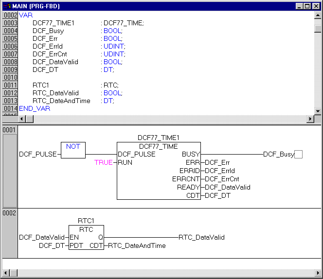

Sample of a call in FBD
In the sample application the Real Time Clock is synchronized with the radio time signal as an error-free signal is received.
