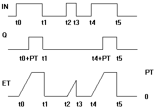

    IN      : BOOL; (* starts timer with rising edge, resets timer with falling edge *)
    PT      : TIME; (* time to pass, before Q is set *)
    Q       : BOOL; (* is TRUE, PT seconds after IN had a rising edge *)
    ET      : TIME; (* elapsed time *)
If IN is FALSE, Q is FALSE and ET is 0.As soon as IN becomes TRUE, the time will begin to be counted in milliseconds in ET until its value is equal to PT. It will then remain constant. Q is TRUE when IN is TRUE and ET is equal to PT. Otherwise it is FALSE. Thus, Q has a rising edge when the time indicated in PT in milliseconds has run out.
Graphic Display of TON Behavior Over Time:
