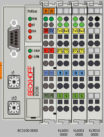

Example Configuration
The following hardware configuration is used with the included test program.
Example Configuration 1:
Handshake
Note that the KL6001 terminal is delivered with active RTS/CTS handshake. The terminal can only transmit if the CTS input is active.In the simplest case, RTS and CTS are linked by a wire bridge for the test, in order to deactivate the handshake.
