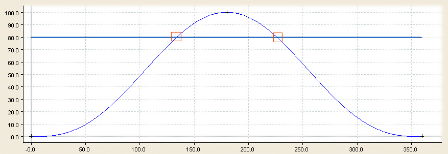

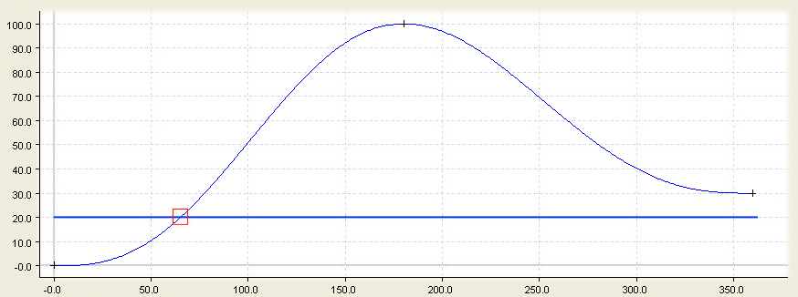

For example, for the cam plate in Fig. 1, for a slave value of 80 and a master start value of 180, the output values are 225 for MasterHigh and 135 for MasterLow. If the cam plate is cyclic, for a master start value of 90 in addition to the MasterHigh of 135 a MasterLow of -135 is calculated. In the linear cam plate case (non-cyclic) only the value MasterHigh is shown as valid in Fig. 2.
MC_ReadCamTableMasterPosition 2:
Fig. 1
In cyclic cam plates with hub the master position can not only lie in one of the cycles adjacent to the StartMasterpos, but several cycles further, depending on the slave position.
MC_ReadCamTableMasterPosition 3:
Fig. 2

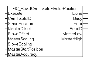

The master position is calculated with numeric algorithms, the precision of which can be set via the variable MasterAccuracy.
Inputs
    Execute            : BOOL;
    CamTableID         : MC_CAM_ID;
    SlavePosition      : LREAL; (* absolute slave axis position *)
    MasterOffset       : LREAL; (* E *)
    SlaveOffset        : LREAL; (* E *)
    MasterScaling      : LREAL := 1.0; (* E *)
    SlaveScaling       : LREAL := 1.0; (* E *)
    MasterStartPosition: LREAL; (* Master position to start the iteration from *)
    MasterAccuracy     : LREAL; (* Master iteration accuracy *)
