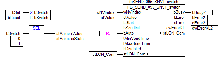

Therefore, create a MAIN program (CFC) in which the FB_LON_KL6401() and EIB_SEND_095_SNVT_switch() function blocks are called up. Make sure to link the communication block with stParameter_IN, stParameter_OUT and stLON_Com.
Link the local variable bSwitch with the global variables bSet and bReset, then with the input of the selection. Link the local variable stValue with the output of the selection, then with the input stValue of the send block.
