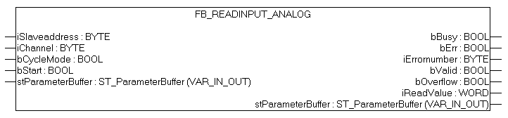

FB_ReadInput_analog
FB_ReadInput_analog 1:
    stParameterBuffer:      ST_ParameterBuffer;
stParameterBuffer: Data buffer for background communication
    iSlaveaddress       :BYTE;
    iChannel            :BYTE;
    bCycleMode          :BOOL;      (*0: Acyclic , 1:Cyclic (permanent Read/Write) *)
    bStart              :BOOL;
iSlaveaddress: Slave address
iChannel: Slave channel
bCycleMode: 0: Acyclic , 1:Cyclic (permanent Read/Write) If this bit is set, the output bBusy will only be reset if the input bStart will become FALSE. If the input bStart becomes to early FALSE, no current value exists at the output.
bStart : Addressing is carried out via a rising edge of this boolean input
    bBusy               :BOOL;
    bErr                :BOOL;
    iErrornumber        :DWORD;     (*errorcode of ASI-Master*)
    bValid              :BOOL;
    bOverflow           :BOOL;
    iReadValue          :WORD;
bBUSY: This output remains TRUE until the block has executed a command. While Busy = TRUE, no new command will be accepted at the inputs. Please note that it is not the execution of the service but its acceptance whose time is monitored.
bErr: This output shows the error status
iErrornumber: Contains the command-specific error code of the most recently executed command. Is reset to 0 by the execution of an instruction at the inputs.
bValid: If this output is set the read data are valid.
bOverflow: The value of the slave is out of range.
iReadvalue: Process value
