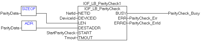

Example of a call in FBD:
IOF_LB_ParityCheck1 : IOF_LB_ParityCheck;
ParityData : ARRAY[1..256] OF BYTE;
StartParityCheck : BOOL;
ParityCheck_Busy : BOOL;
ParityCheck_Err : BOOL;
ParityCheck_ErrId : UDINT;
