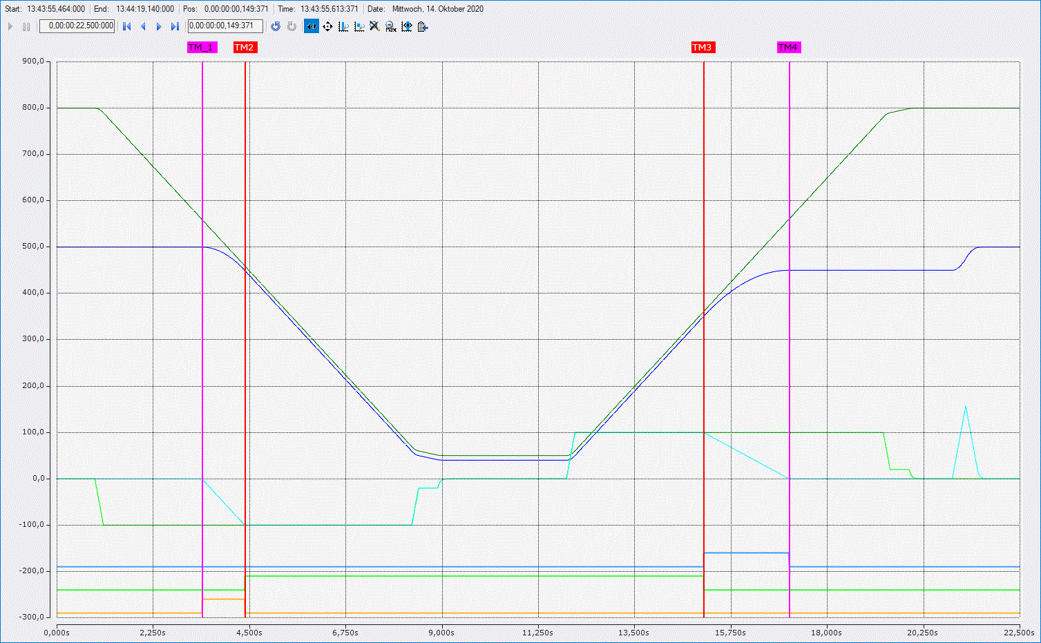

Sample #1
Here, master and slave move in the same direction. Both return to their starting position.
Preparation:
- The master was positioned at 800.0 mm.
- The slave was positioned at 500.0 mm.
- The location at which the slave begins with the establishment of the synchronization is thus defined.
- The final coupling factor (ratio) has been set to 1.0 for better understanding. In practical use, this factor is often chosen slightly smaller in order to trigger a transition to a pressure or force control.
- The point for achieving synchronization has been set to 460.0 mm for the master (MasterSyncPosition) and 450.0 mm for the slave (SlaveSyncPosition).
- The difference of 10.0 mm between master and slave represents the distance required for material, tools and other installations and is chosen here in such a way that the representation illustrates the behavior.
- The distance for synchronizing the slave is calculated from the starting position of the slave and the SlaveSyncPosition and is in this case 500.0 - 450.0 => 50 mm.
- With a ratio of 1.0, the master has a distance to synchronize of 2.0 * 50 mm => 100 mm. So the synchronization of the master will start at 460.0 mm+100 mm => 560 mm (MasterSyncPosition plus distance). If the master is below this position when the coupling is enabled, an error is signaled.
- The point for leaving the synchronization has been set to 450.0 mm for the slave (SlaveDesyncPosition).
- The point for the complete release of the coupling (SlaveStopPosition) has been set to 500.0 mm. The intended distance for this is thus 500.0 mm – 450 mm => 50 mm.
- With a ratio of 1.0, the master will also travel a distance of 2.0 * 50 mm => 100 mm.
- Distances that the master travels before TM_1 and after TM_4 in the above scope do not concern the slave.
- If the master changes its speed between TM_1 and TM_2 or between TM_3 and TM_4, the slave will take this into account. Then its speed curve may be less clear than in the above scope.

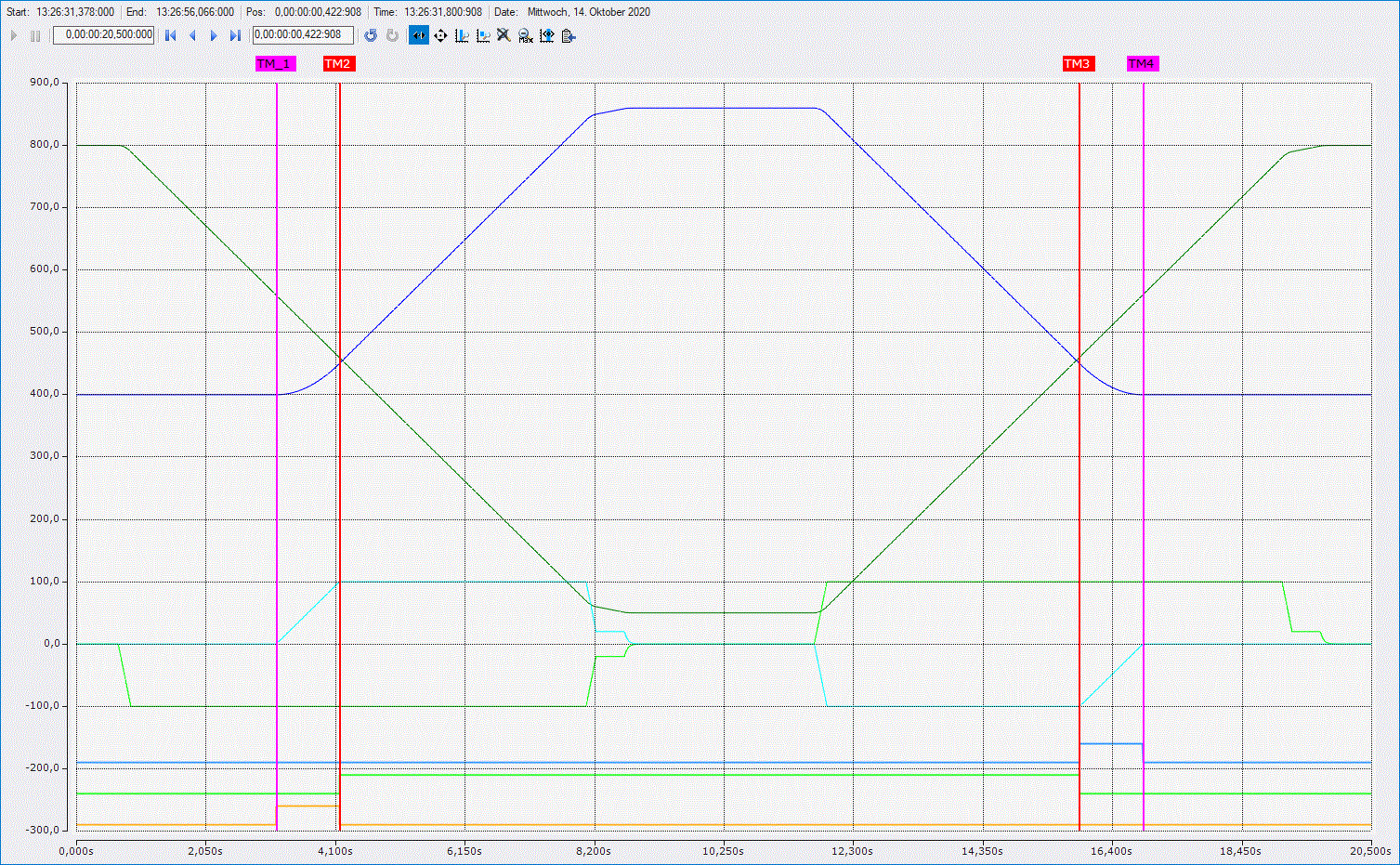

Sample #2
Here, the master and slave move in opposite directions. Both return to their starting position.
- Here, the starting position is not 50 mm above the SlaveSyncPosition, but by the same amount below it.

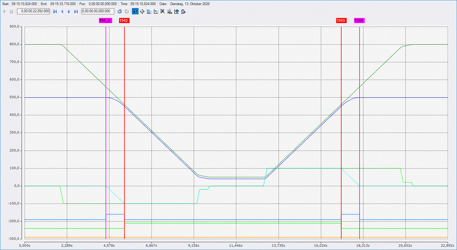

Sample #3
Here, master and slave move in the same direction. However, the slave only returns to its starting position by means of an MC_MoveAbsolut_BkPlcMc().
- Here, the initial situation is the same as in the sample #1.
- However, the SlaveStopPosition is different here. The slave accordingly stops earlier.
- The distance between SlaveDesyncPosition and SlaveStopPosition is 100 mm here. As a result, the release of the coupling creates a different profile than the establishment of the coupling.
- Once the master has completed its movement, the function block is deactivated and the slave is driven to the starting position with its own command.
