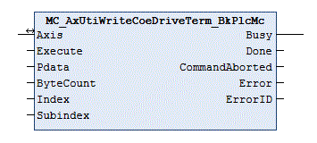

MC_AxUtiWriteCoeDriveTerm_BkPlcMc (from V3.0)
The function block writes the contents of a register of the EL terminal, which is used as drive interface for the axis.

Name | Type | Description |
Execute | BOOL | The writing process is initiated by a rising edge at this input. |
Pdata | POINTER | The address of the variable whose content is to be written to the terminal must be specified here. |
ByteCount | BYTE | Here, the size of the variable is specified in bytes. |
Index | WORD | Here, the addressing of parameter in the terminal is specified. |
Subindex | BYTE |
Inputs/outputs
VAR_INOUT
Axis: Axis_Ref_BkPlcMc;
Axis | Axis_Ref_BkPlcMc | Here, the address of a variable of type Axis_Ref_BkPlcMc should be transferred. |
