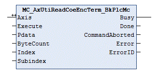

MC_AxUtiReadCoeEncTerm_BkPlcMc (from V3.0)
The function block reads the contents of a register from the EL terminal, which is used as encoder interface for the axis.

Name | Type | Description |
Execute | BOOL | A rising edge at this input starts the read process. |
Pdata | POINTER | Here, the address of the variable is specified, in which the read value is to be output. |
ByteCount | BYTE | Here, the size of the variable is specified in bytes. |
Index | WORD | Here, the addressing of parameter in the terminal is specified. |
Subindex | BYTE |
Axis | Axis_Ref_BkPlcMc | Here, the address of a variable of type Axis_Ref_BkPlcMc should be transferred. |
Busy | BOOL | Indicates that a command is being processed. |
Done | BOOL | Successful loading of the parameter is indicated here. |
CommandAborted | BOOL | Indicates abortion of the read operation. |
