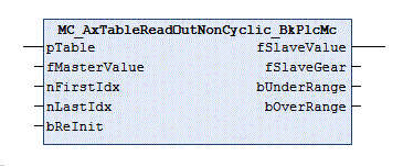

MC_AxTableReadOutNonCyclic_BkPlcMc (from V3.0)
The function block determines the slave values assigned to a master value with the aid of a table.
![]() | This function block is a component of cam plates or similar non-linear couplings. It is generally not called direct by an application. |

The function block searches inside the transferred table for a master pair of values, which matches or includes the transferred fMasterValue. Within the found intervals a linear intermediate interpolation is calculated. The result is output as fSlaveValue. The local slope determined in this calculation is output as fSlaveGear.
If fMasterValue is below the value range described by the table, bUnderRange is indicated. The value output as fSlaveValue is the value assigned to the lowest point of the table. 0.0 is returned as fSlaveGear.
If the fMasterValue is above the range of values described by the table, bOverRange is indicated. The value output as fSlaveValue is the value assigned to the top point of the table. 0.0 is returned as fSlaveGear.
The return value fSlaveGear represents the ratio of the first derivatives of fMasterValue and fSlaveValue. If fMasterValue represents a position or a virtual time, the multiplication of master progress velocity and fSlaveGear returns the set slave velocity. This can be used to generate a pilot-control velocity. An MC_AxRtSetExtGenValues_BkPlcMc function block is preferable for this purpose.
