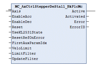

The function block monitors the motion of a stepper motor axis, which is operated with an encoder.

Inputs
EnableAcc: BOOL:=FALSE;
EnableDec: BOOL:=FALSE;
Reset: BOOL:=FALSE;
UseKL2531State: BOOL:=FALSE;
ResetRefOnError: BOOL:=FALSE;
FirstAuxParamIdx:INT:=0;
VeloLimit: LREAL:=0.0;
LimitFilter: LREAL:=0.0;
UpdateFilter: LREAL:=0.0;
Name | Type | Description |
EnableAcc | BOOL | These inputs determine whether the monitoring may intervene during the acceleration and braking phases. |
EnableDec | BOOL | |
Reset | BOOL | This input controls the activity of the controller. |
UseKL2531State | BOOL | If TRUE is transferred here, the function block evaluates ST_TcPlcDeviceInput.bTerminalState. |
ResetRefOnError | BOOL | If TRUE is transferred here, the function block clears the reference flag of the axis. |
FirstAuxParamIdx | INT | Here a range in the Axis_Ref_BkPlcMc.ST_TcHydAxParam.fCustomerData can be activated as parameter interface. |
VeloLimit | LREAL | The threshold for the velocity deviation, from which the stall situation is detected. |
LimitFilter | LREAL | The time over which an excessive velocity deviation must be present continuously for the stall situation to be detected. |
UpdateFilter | LREAL | The time constant, with which the velocity control value in the function block is adjusted to the actual velocity. |
Inputs/outputs
VAR_INOUT
Axis: Axis_Ref_BkPlcMc;
Axis | Axis_Ref_BkPlcMc | Here, the address of a variable of type Axis_Ref_BkPlcMc should be transferred. |
Outputs
Active: BOOL;
Activated: BOOL;
Error: BOOL;
ErrorID: UDINT;
Active | BOOL | Indicates that a stall situation was detected. |
Activated | BOOL | Indicates that a stall situation was detected since the last start of an active axis movement. |

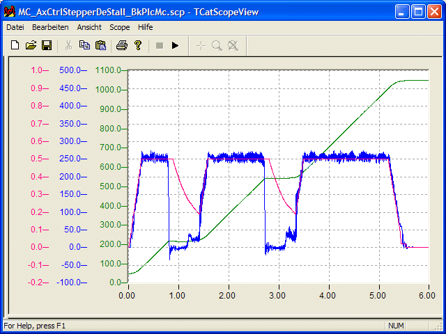

The following Scope View shows a positioning, during which an obstacle was encountered twice. In each case the axis stopped completely.
