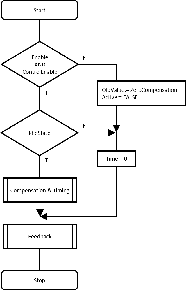

Behavior of the function block: Enable logic
As long as Enable for the function block or the axis controller is FALSE, the function block does not become Active. The comparison value for monitoring the compensation is initialized and the time measurement for the Done message is reset.
If the enable conditions are met and the axis is not in idle state (i.e. it is in motion), the time measurement for the Done message is also reset.
If the enable conditions are met and the axis is in idle state, the function block 'Compensation&Timing' is processed.
Irrespective of these preconditions, the function block' Feedback' is processed.
Enable logic:

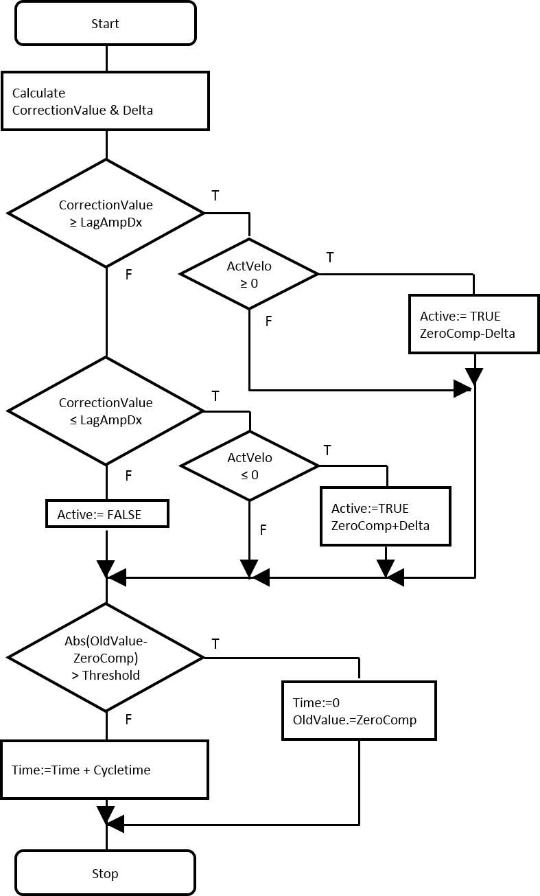

Behavior of the function block: Compensation&Timing
A correction value is formed from the lag error and the response of the controller. The bandwidth of the possible axis controller parameterization is taken into account. A delta value (maximum change in zero compensation per cycle) is formed from this correction value and Tn. Tn defines a ramp time for an increase by 10 V. The delta value is limited such that this ramp slope is not exceeded. In this way an excessively fast change, during which the correction would become unstable, can be avoided. Values greater than 100 seconds are recommended.
A tolerance threshold is used for compensation. In this case LagAmpDx (threshold value of the I component in the position controller) is used.
If the correction value is greater than or equal to the tolerance threshold and the actual velocity is greater than or equal to zero (i.e. the remaining correction value is not already reduced), the Active function block is used and the compensation is reduced in each cycle by the delta value described.
If the correction value is less than or equal to the tolerance threshold and the actual velocity is less than or equal to zero (i.e. the remaining correction value is not already reduced), the Active function block is used and the compensation is reduced in each cycle by the delta value described.
If the magnitude of the correction value is smaller than the tolerance threshold, Active becomes FALSE.
If the compensation differs by more than the Threshold from the OldValue comparison value, the time measurement is reset and the current compensation is updated as a new comparison value. Otherwise, the time measurement is increased with the cycle time. In this way, the time required to accumulate a change in compensation by at least the Threshold is logged.
Compensation&Timing:

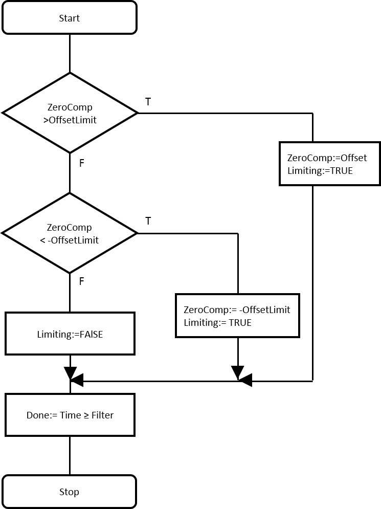

Behavior of the function block: Feedback
The compensation is limited to ±OffsetLimit and signaled to Limiting.
Done is reported when the function block is active and the time measurement reaches the time set in Filter. Example: If Threshold is set to 0.05 and Filter to 2.0, Done is reported if the compensation has been readjusted by less than 0.05 V within the last 2 seconds.
Feedback
![]() | The limitation to the range specified by OffsetLimit applies even if the function block is not active. The Limiting output is updated. |
The value OffsetLimit and ST_TcHydAxParam.fZeroCompensation are regarded as offset voltage. The value 10.0 therefore corresponds to full scale control. In general, a value between 0.1 and 1.0 makes sense for OffsetLimit, depending on the application.
