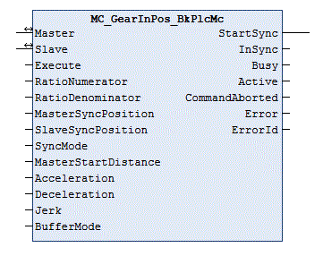

MC_GearInPos_BkPlcMc (from V3.0.33)
The function block starts and monitors an on-the-fly coupling between two axes. To release the coupling, an MC_GearOut_BkPlcMc function block should be used.

On a rising edge at Execute the function block checks the transferred axis interface. A number of problems can be detected and reported during this process:
- Next, the system checks whether RatioDenominator is 0. In this case the system responds with Error and ErrorID:=dwTcHydErrCdIllegalGearFactor.
- If RatioDenominator is less than 0, the system responds with Error and ErrorID:=dwTcHydErrCdNotSupport.
- The coupling can only be activated if the slave is at standstill. Otherwise the system responds with Error and ErrorID:=dwTcHydErrCdNotStartable.
- If the absolute value of the MasterStartDistance is too small, the system responds with Error and ErrorID:=dwTcHydErrCdCannotSynchronize.
- If the actual position of the master is not between MasterSyncPosition and the end of the synchronization distance specified by MasterStartDistance, the system responds with Error and ErrorID:=dwTcHydErrCdCannotSynchronize.
If these checks could be performed without problem, the coupling is initiated. The slave axis initially continues to be in state McState_Standstill. Only when the master axis reaches the start of the synchronization distance for the first time does the slave axis report McState_Synchronizedmotion and indicate StartSync, and the function block starts monitoring the coupling. As soon as the axis reaches the end the synchronization distance for the first time, the slave axis indicates InSync. Should the master axis later pass the start of the synchronization distance backwards, the coupling is not released.
If an error code occurs in the motion generator while the coupling is active, the system responds with Error and ErrorID:=motion algorithm error code.
A falling edge at Execute clears all the pending output signals. If Execute is set to FALSE while the coupling is still active, the existing coupling remains unaffected and active.
