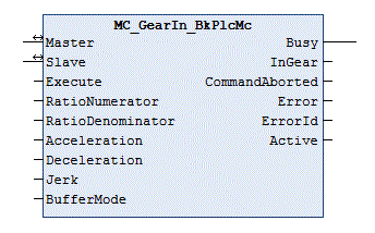

MC_GearIn_BkPlcMc (from V3.0)
The function block starts and monitors a coupling between two axes. To release the coupling, an MC_GearOut_BkPlcMc function block should be used.

Inputs/outputs
VAR_INOUT
Master: Axis_Ref_BkPlcMc;
Slave: Axis_Ref_BkPlcMc;

Outputs
Busy: BOOL;
InGear: BOOL;
CommandAborted: BOOL;
Error: BOOL;
ErrorID: UDINT;
Active: BOOL;
