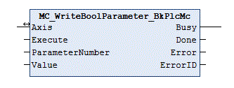

MC_WriteBoolParameter_BkPlcMc (from V3.0)
This function block writes the boolean parameters of an axis. The function block MC_WriteParameter_BkPlcMc is available for non-boolean parameters.
Inputs
Enable: BOOL;
ParameterNumber: INT;
Value: BOOL;
Name | Type | Description |
Enable | BOOL | A write process is initiated by a rising edge at this input. |
ParameterNumber | INT | This code number specifies the parameter that is to be read. Only named constants from E_TcMCParameter should be used. |
Value | BOOL | The value of the parameter is to be provided here. |
Inputs/outputs
VAR_INOUT
Axis: Axis_Ref_BkPlcMc;
Axis | Axis_Ref_BkPlcMc | Here, the address of a variable of type Axis_Ref_BkPlcMc should be transferred. |
Outputs
Busy: BOOL;
Done: BOOL;
Error: BOOL;
ErrorID: UDINT;
Busy | BOOL | Indicates that a command is being processed. |
Done | BOOL | Successful execution of the writing process is indicated here. |
On a rising edge at Enable the function block checks the transferred axis interface. A number of problems can be detected and reported during this process:
- If an unsupported value is given to ParameterNumber the system responds with Error and ErrorID:=dwTcHydErrCdNotSupport.
If these checks could be performed without problems Value is entered into the desired parameter value and Done is reported. If the parameter is changed in the process Axis_Ref_BkPlcMc.ST_TcHydAxRtData.bParamsUnsave is set.
A falling edge at Enable clears all the pending output signals.
![]() | This function block requires no time for executing its tasks. The output Busy will never assume the value TRUE and only exists for compatibility reasons. |
