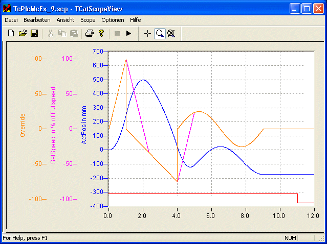

If the Enable state is active, the value transferred as VelOverride is limited to the range 0.0 to 1.0 and entered in Axis.pStAxParams^.fOverride. Enabled is set to TRUE.
A falling edge at Enable clears all outputs.
All velocity changes caused by an override modification are limited according to the maximum permitted accelerations and decelerations.
![]() | In order to ensure reproducible behavior during the target approach, the override only reduces the travel speed to pStAxParams.fCreepSpeed. Therefore, it is not possible to stop the axis movement through an override of 0.0. |
