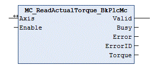

MC_ReadActualTorque_BkPlcMc (from V3.0)
The function block determines the current actual force or actual pressure of an axis.
Inputs
Enable: BOOL;
Name | Type | Description |
Enable | BOOL | A rising edge at this input triggers an update of the actual value. |
Inputs/outputs
VAR_INOUT
Axis: Axis_Ref_BkPlcMc;
Axis | Axis_Ref_BkPlcMc | Here, the address of a variable of type Axis_Ref_BkPlcMc should be transferred. |
Outputs
Valid: BOOL;
Busy: BOOL;
Error: BOOL;
ErrorID: UDINT;
Torque: LREAL;
Valid | BOOL | This indicates successful determination of the actual value. |
Busy | BOOL | This output is TRUE while the command is being processed. |
Torque | LREAL | The actual force or actual pressure. |
On a rising edge at Enable the function block checks the transferred axis interface. A number of problems can be detected and reported during this process:
- If the axis is in an error state and the cause is an encoder problem, the response is Error and ErrorID:=error code of the encoder.
If these checks were completed without problem, the actual force or the actual pressure is determined, and Valid is reported.
A falling edge at Enable clears all the pending output signals.
![]() | This function block requires no time for executing its tasks. The output Busy will never assume the value TRUE and only exists for compatibility reasons. |
