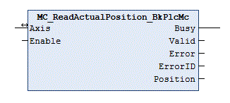

MC_ReadActualPosition_BkPlcMc (from V3.0)
The function block determines the current position of an axis.

On a rising edge at Enable the function block checks the transferred axis interface. A number of problems can be detected and reported during this process:
- If the axis is in an error state and the cause is an encoder problem, the response is Error and ErrorID:=error code of the encoder.
The actual position is determined and Valid is reported if these checks can be carried out without problems.
A falling edge at Enable clears all the pending output signals.
