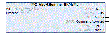

MC_AbortHoming_BkPlcMc
The function block is used to cancel a referencing process.

On a rising edge at Execute the function block checks the transferred axis interface whether an active movement is executed. If the axis is not in an active movement, referencing is aborted directly. If the axis is in an active movement, this movement is stopped via a MC_Stop_BkPlcMc. If the stop is successful, the function block reports Done. If an error occurs during the stop, this error is indicated via Error and ErrorId.
A falling edge at Execute clears all the pending output signals. If, while the movement is still active, Execute is set to FALSE, execution of the command that had started continues unaffected
