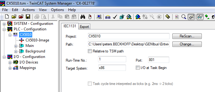

TwinCAT System Manager
In the TwinCAT System Manager the variables are already linked and assigned to the two tasks (Background: fast for communication, Main: slower for application).
Compile the PLC program and read it into the TwinCAT System Manager:
In accordance with these instructions, check whether the variable assignment is correct and that the variables have been linked.
After that you can start the TwinCAT System Manager and load and start the PLC program.
