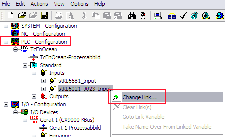

KL6021-0023 - Linking to the System Manager
  1. Link the PLC program and click with the right mouse button on the data structure.
  2. KL6021-0023 - Linking to the System Manager 1:
    Figure 1

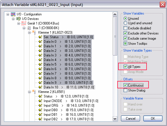

  3. Select "All Types" and "Continuous" (see Figure 2).
  4. KL6021-0023 - Linking to the System Manager 2:
    Figure 2
  5. Click with the mouse on the first variable of the EnOcean bus terminal KL6021-0023 ‘Ser.Status’. Then press the <SHIFT> key, and hold it down.
  6. Move the mouse pointer over the last variable of the KL6021-0023 ‘Data In 10' and click again with the left mouse button.
  7. Now release the <SHIFT> key again. All the terminal's data should now be highlighted (see Figure 2).
  8. Press button "OK"
  9. Check the links
