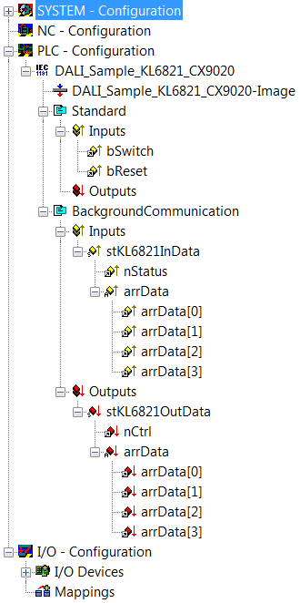

Configuration in the System Manager
Create a new TwinCAT System Manager project, select the CX as the target system, and search for the associated hardware.
Add the PLC program created above under PLC configuration. The two tasks are listed when the PLC project is expanded in the tree view. Expand the tasks – all global input and output variables should be allocated to the standard task. However, since the variables stDALIInData and stDALIOutData are to be processed faster, move them to the background communication task via drag & drop.
KL6821 Integration into TwinCAT (CX9020) 5:
Now link the global variables of the PLC program with the Bus Terminal inputs and outputs, create the allocations, and activate the configuration. Then start the device in run mode.
