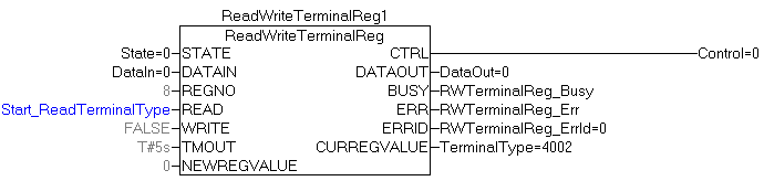

Example 1
In Example 1 the terminal identifier is read from register 8 of an analog output terminal. The variables State, Control, DataIn and DataOut are linked to the terminal's corresponding I/O variables in the TwinCAT System Manager. The terminal identifier is KL4002..

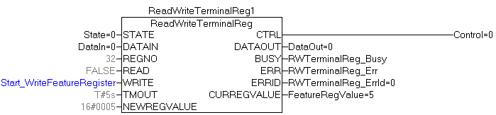

Example 2
In Example 2 the user-scaling is activated in the feature register (register 32) of a KL4002 analog output terminal. The new value in the feature register is then read by the function block, and can be checked through the output variable CURREGVALUE.
