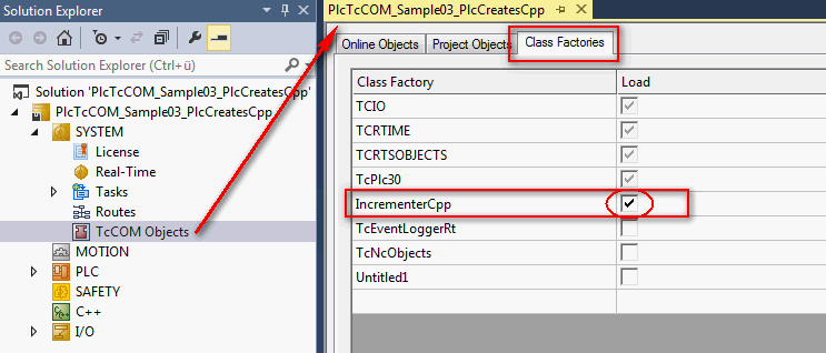

- 1. Open a TwinCAT project or create a new project.
- 2. Select the required C++ driver in the solution under the TcCOM Objects node in the Class Factories tab.
- This ensures that the driver is loaded on the target system when TwinCAT starts up. In addition this selection provides for the described deployment.
