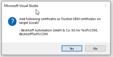

4. When activating the TwinCAT configuration for the first time, the test certificate must be accepted:
