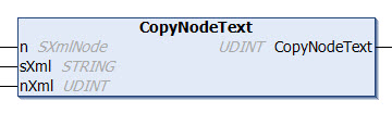

This method reads the value of an XML node and writes it to a variable of data type String. The XML node as well as the target variable and the length to be written are passed to the method as input parameters. The method returns the actual size.
Syntax
METHOD CopyNodeText : UDINT
n : SXmlNode;
VAR_IN_OUT CONSTANT
sXml : STRING;
nXml : UDINT;
Return value
Name | Type |
CopyNodeText | UDINT |
Inputs
Name | Type |
n | SXmlNode |
nXml | UDINT |
Inputs/Outputs
Name | Type |
sXml | STRING |
Sample call:
nLength := fbXml.CopyNodeText(xmlNode, sTarget, SIZEOF(sTarget));
