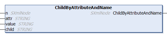

ChildByAttributeAndName
ChildByAttributeAndName 1:
This method is used to navigate through the DOM. It returns a reference to a child element in the XML document. The start node, the name and value of the attribute, and the name of the child element are transferred to the method as input parameters.
Syntax
METHOD ChildByAttributeAndName : SXmlNode
  n     : SXmlNode;
VAR_IN_OUT CONSTANT
  attr  : STRING;
  value : STRING;
  child : STRING;
ChildByAttributeAndName 2: Return value
Type
SXmlNode
ChildByAttributeAndName 3: Inputs
Type
n
SXmlNode
ChildByAttributeAndName 4:/ChildByAttributeAndName 5: Inputs/Outputs
Type
attr
STRING
value
STRING
child
STRING
Sample call:
xmlMachine2 := fbXml.ChildByAttributeAndName(xmlMachines, 'Type', '2', 'Machine');
