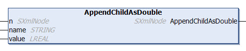

This method inserts a new node below an existing node. The value of the new node has the data type Double. The name and value of the new node and a reference to the existing node are transferred to the method as input parameters. The method returns a reference to the newly added node.

Sample call:
xmlNewNode := fbXml.AppendChildAsDouble(xmlExisting, 'SomeName', 42.42);
