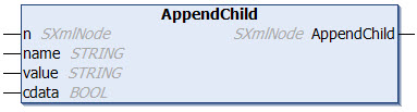

This method inserts a new node below an existing node. The value of the new node is of the data type STRING. The name and the value of the new node as well as a reference to the existing node are transferred to the method as input parameters. The method returns a reference to the newly added node. The input parameter cdata indicates whether the value of the node is to be encapsulated in a CDATA function block, so that certain special characters such as "<" and ">" are allowed as values.
Syntax
METHOD AppendChild : SXmlNode
  n     : SXmlNode;
VAR_IN_OUT CONSTANT
  value : STRING;
  cdata : BOOL;
AppendChild 2: Return value
Type
AppendChild
SXmlNode
AppendChild 3: Inputs
Type
n
SXmlNode
cdata
AppendChild 4:/AppendChild 5: Inputs/Outputs
Type
name
STRING
value
STRING
Sample call:
xmlNewNode := fbXml.AppendChild(xmlExisting, 'Controller', 'CX5120', FALSE);
