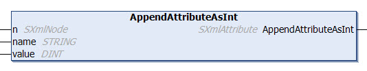

AppendAttributeAsInt
AppendAttributeAsInt 1:
This method adds a new attribute to an existing node. The value of the attribute has the data type Integer. The name and value of the new attribute and the existing XML node are transferred to the method as input parameters. The method returns a reference to the newly added attribute.
Syntax
METHOD AppendAttributeAsInt : SXmlAttribute
  n     : SXmlNode;
VAR_IN_OUT CONSTANT
  value : DINT;
AppendAttributeAsInt 2: Return value
Type
SXmlAttribute
AppendAttributeAsInt 3: Inputs
Type
n
SXmlNode
value
DINT
AppendAttributeAsInt 4:/AppendAttributeAsInt 5: Inputs/Outputs
Type
name
STRING
Sample call:
objAttribute := fbXml.AppendAttributeAsInt(objMachine, 'Name', 42);
