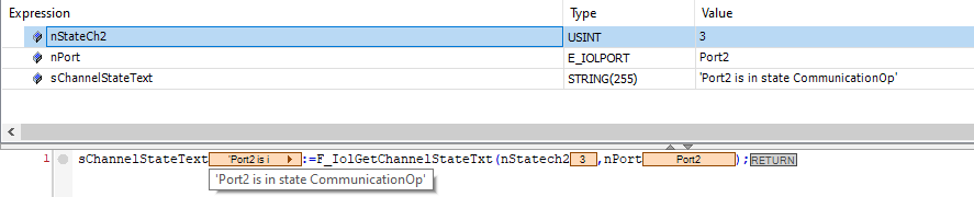

Example
  nStateCh2  AT%I*    :USINT;
  nPort               :E_IolPort:=E_iolPort.Port2;
  sChannelStateText   :STRING(255);
sChannelStateText := F_IolGetChannelStateTxt(nStateCh2,nPort);
