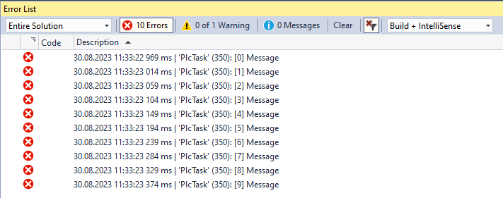

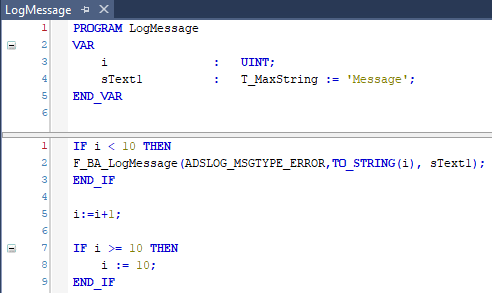

F_BA_LogMessage 2:
The F_BA_LogMessage function is run in ten consecutive cycles, then no more. The log type is ADSLOG_MSGTYPE_ERROR, which means that the message output is of the error message type. The variable sLogCode is assigned the control variable i, which appears in the text in square brackets. The input variable sLogText of the function contains the text "Message".
Output
F_BA_LogMessage 3:
The generated code is used to identify a specific location in the source code. The sample shown above serves to illustrate how this function works. Basically, a distinctive abbreviation (e.g. "IO50" if a message is issued within the method InitObject in line 50) should be explicitly specified for the generation of the log messages.
This will display an error at runtime and the shortcut "Ctrl+F" will reach the erroneous location.
