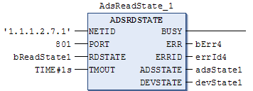

Sample of calling the function block in FBD:
In this sample the PLC runtime system 1 (port no. 801) on the computer with network address 1.1.1.2.7.1 is asked about its state. The answer is adsState = 1 (IDLE) without supplementary code devState=0.
