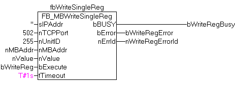

Example of calling the block in FBD:
PROGRAM Test
fbWriteSingleReg : FB_MBWriteSingleReg;
bWriteReg : BOOL;
bWriteRegBusy : BOOL;
bWriteRegError : BOOL;
nWriteRegErrorId : UDINT;
nMBAddr : WORD := 4;
nValue : WORD := 16#1234;
After a rising edge of "bExecute" and successful execution of the WriteSingleReg command, the value 16#1234 is written into register 5.
