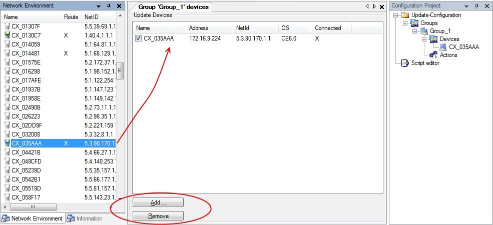

TwinCAT routes must be available for the devices with which you want to work. You can do this conventional via the TwinCAT System Manager or directly in the configurator by right-clicking on the selected device in the Network Environment. In the context menu that opens you can use the Add Route option and enter a route in the same way as in the System Manager. You can now copy the devices via drag and drop from the Network Environment into the window of the Devices subitem. Alternatively, you can use the Add button in the Devices window. If the Cab file has been installed correctly on the target device, an "X" will appear in column Connected after a few seconds. Once this "X" appears the target device is able to process the scripts created in the configurator.

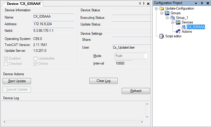

Further device information can be obtained by selecting a device in the Configuration Project.

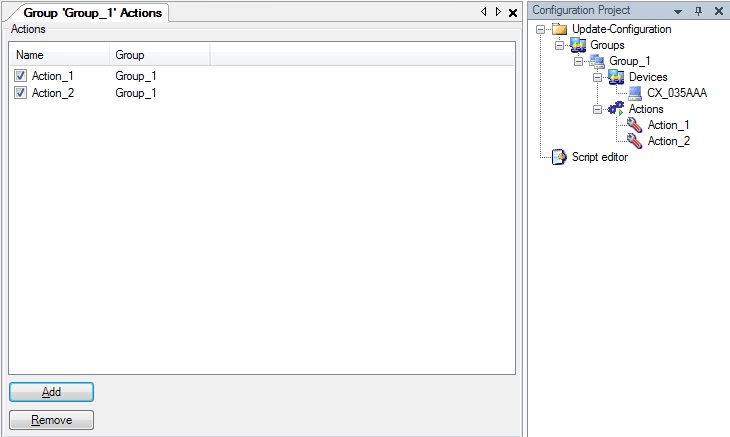

Under the Actions subitem of a group you can create script-based actions to be started on the devices.
For this example, two actions will be created. The first action updates the complete image of the previously selected CX1020 from HPS 3.21d to HPS 3.21h. The second action is a simple file copying process.
Actions can be added by right-clicking on the subitem New in the context menu of the Configuration Project or via Add in the Actions window.

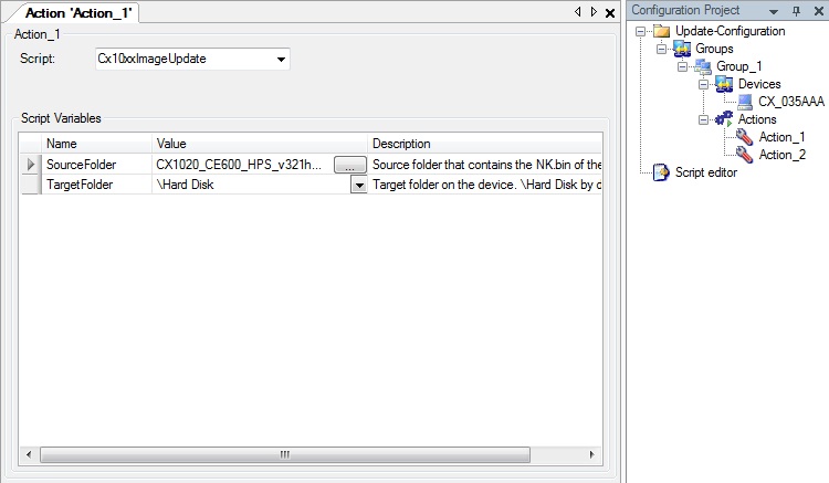

For the first action you have to select the script Cx10xxImageUpdate. Enter the folder for the new image in the SourceFolder field via the browser button. Select "\Hard Disk" as the TargetFolder for an image update on the device. The preparations for the first action are now complete.

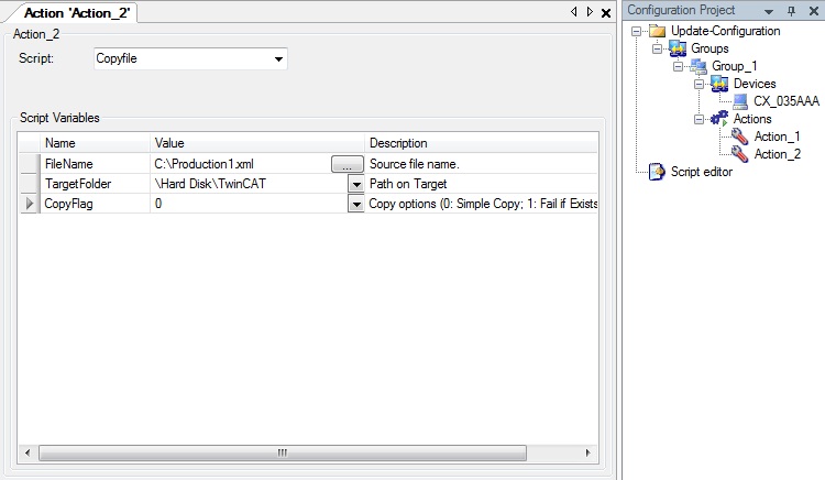

For the second action please select the Copyfile script. The aim is to copy an important production file to the device. Under FileName you can navigate to the required file. Specify the target directory under TargetFolder and the copy option under CopyFlag. In this case copy option "0" is selected, which means a simple copy process.

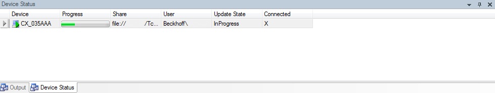

Under Device Status you can monitor the progress of the operations. Once Finished appears under Update State, highlighted in green, the operations for the respective device have been completed successfully. More detailed information about the device-specific update can be obtained by clicking on the respective device in the Configuration Project.
