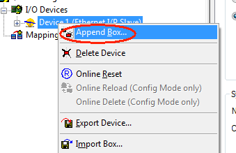

- Append an EtherNet/IP Slave Box as shown below
