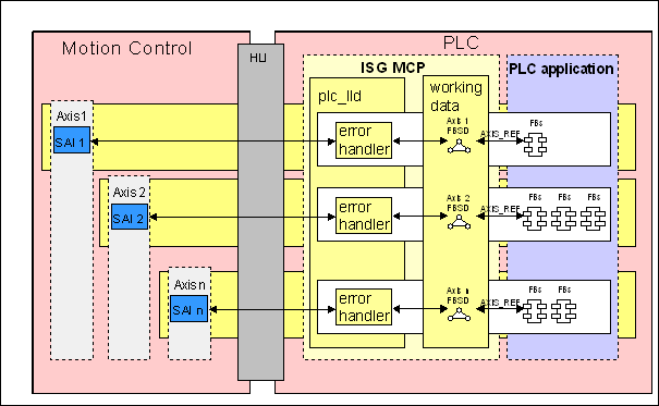

At this point, you could conclude that the FB places the FBSD in an error state in the event of an inadmissible command because it is a command issuing state automaton. According to the PLCopen specification, however, this is not the case because the following applies to the FBSD:
Note 3: The transition Error refers to errors from the axis and axis control, and not from the Function Block instances.
These axis errors may also be reflected in the output of the Function Blocks FB instances errors.
This means that a motion FB never places the FBSD in the ERROR state, but only results in an error that is reported by the motion controller. To this end, it is necessary for an axis-specific handler process to obtain the error messages from the HLI and to store them in the axis-specific work data, i.e. in the FBSD. The individual FBs then see the error state of the axis via their AXIS_REF.
Error handling at the FBSD level 1:
Figure 1-13: Error handler supplies the axis-specific FBSD work data
