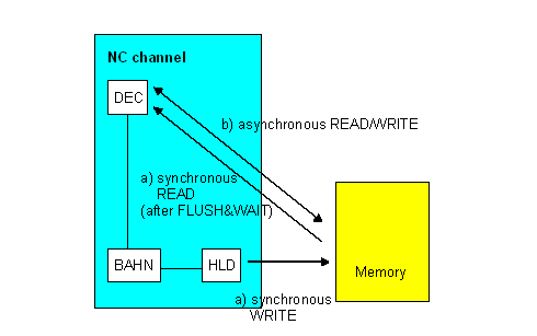

Since this synchronization, in particular halting of decoding in the case of Read access, has undesirable runtime influences, this implicit synchronization can be deactivated when defining the variables. Of course, this is possible only if the instant of read access does not need to be synchronous with processing or if this is ensured anyway by an explicit synchronization point in the NC-program (e.g. explicit FLUSH & WAIT).
Fig.5: Asynchronous/synchronous access of decoding (DEC) and processing (BAHN) via PLC driver (HLD)
The output of synchronized VE variables and the output of technology functions (M-/H-/T- functions) with synchronization type MOS take place via the same interface. The user must ensure, that all data in the queue of the interface are consumed by the PLC, otherwise the synchronicity to the NC channel is not guaranteed. |
