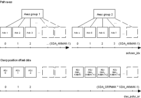

Classification of the clamp position offset data 1:Fig.1: Assignment of clamp position offset data to logical axes.

The axis index is according to the channel-internal axis number (see Fig. 1). The initial axis configuration of the NC-channel is set in the channel parameters [CHAN].
