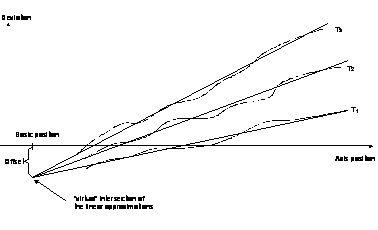

The compensation values are approximated by a linear straight line. This straight line is defined by a basic position, an offset at this position and a geometrical pitch. Depending on the temperature these parameters can be adjusted e.g. by the PLC.
Parameters for temperature compensation (P-AXIS-00272/P-AXIS-273/P-AXIS-274) 1:Fig.6: Reference measuring at different temperatures
