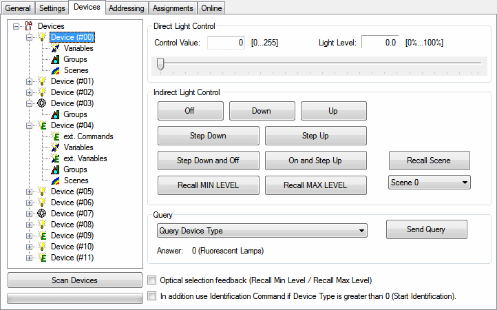

Device
Standard 1:
For the most important functions, here are buttons for going to send a corresponding DALI-command to the selected device.

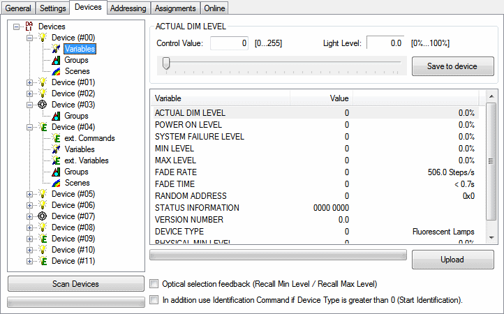

Variables
Standard 2:
With DALI, the intelligence was not centralized to 100%. This means, that many settings and light-levels in the form of variables are stored in the ballast. The Variables-menu displays a dialog, where you can review and edit the variables of the selected DALI-device.

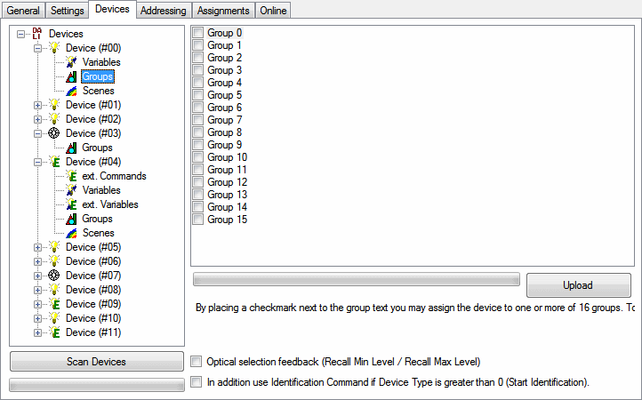

Groups
Standard 3:
In this menu you can add each DALI-device up to 16 groups. When a DALI-device receives a command in conjunction with a parameterized group-number, it will execute this command.

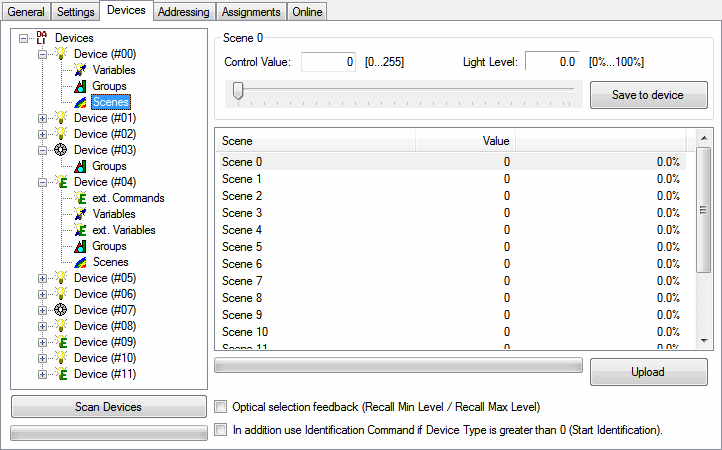

Scenes
Standard 4:
Here you can store 16 different light-levels for scenes on each DALI-device. When a DALI-device receives a parameterized scene-number (e.g., as part of a broadcast), it will set the light-intensity for the scene. If the value of 255 (mask) is stored for this scene, the DALI-device retains the previous value.
