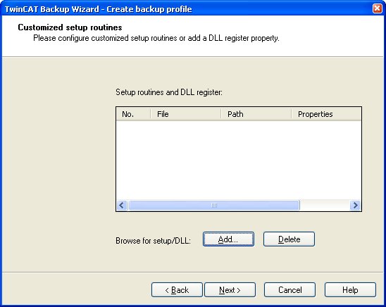

    Installing TwinCAT during a restore process 1:
1. Add the TwinCAT installation in the backup configuration via 'Add...':

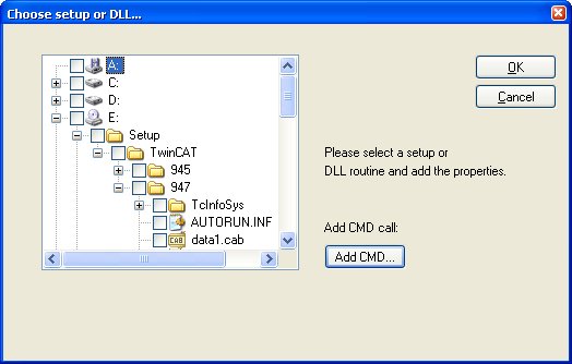

Installing TwinCAT during a restore process 2:
2. Browse for the 'Setup.exe' for the installation:
Installing TwinCAT during a restore process 3:

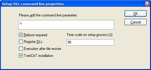

3. Set the parameters as follows:
Installing TwinCAT during a restore process 4:
