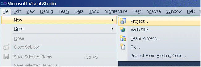

The TwinCAT.ADS component can only be integrated in an existing project. Start VS and select the following command from the menu: File->New->Project...

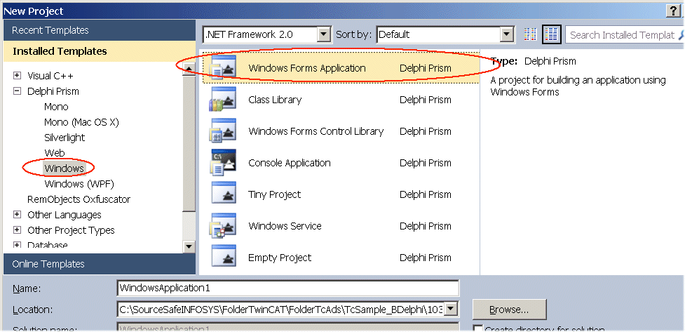

In the New Project dialog please select as project type: Delphi Prism->Windows Forms Application.

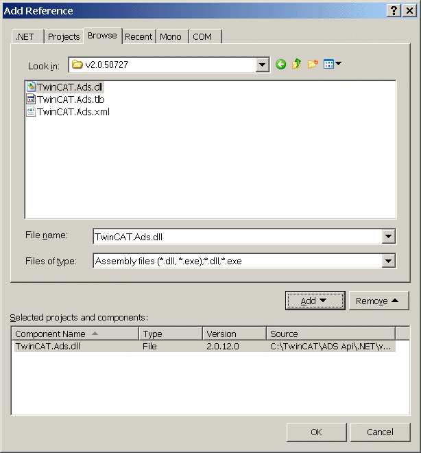

To select the class library TwinCAT.ADS select the command Add Reference... from the Project menu. The Add Reference dialog opens.
In this dialog should select the Browse tab and navigate to file TwinCAT.ADS.dll. Confirm the selected dll with Add and OK. By default the TwinCAT.ADS component is located in folder ..TwinCAT\Ads Api\.NET\ .

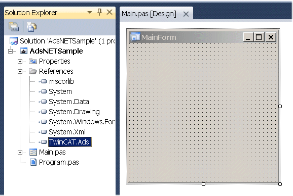

The project manager offers an option for checking whether the component was added to the reference list.
