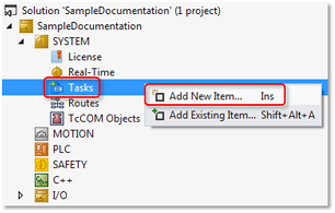

Task Management
Create new task
Task Management 1:
Add New Item
Opens the dialog Insert Task, where a new task can be configured.
Add Existing Item
Opens the standard dialog for selecting a file, via which an already existing task can be added to the project.

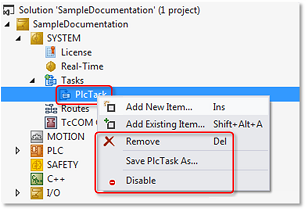

Task Management 2:
Add New Item
Add Existing Item
Remove
Removes the selected task from the project.
Save Plc Task as
Saves the task with the possibility to change the name.
Disable
Sets the selected task to the inactive state (not considered for the project creation), but the configurations and shortcuts are preserved and can be reactivated.

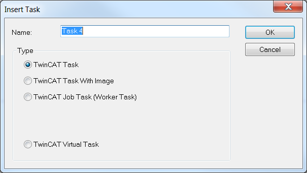

Dialog Insert Task
Task Management 3:
Name of the task
OK
The task is created.
Cancel
The process is canceled and the dialog is closed.
TwinCAT Task
Selection of a "normal" TwinCAT Task.
TwinCAT Task With Image
Selection of a task with its own process image.
TwinCAT Job Task (Worker Task)
Selection of a Job Task.
