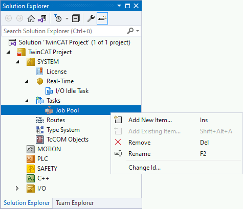

Context menu
Add New Item… | Creates a new Job Task. |
Add Existing Item… | Loads an existing Job Pool configuration from an XTI file. |
Remove | Removes the Job Pool from the configuration. |
Rename | Rename the Job Pool. |
Change Id… | Change the ID of the Job Pool. |
