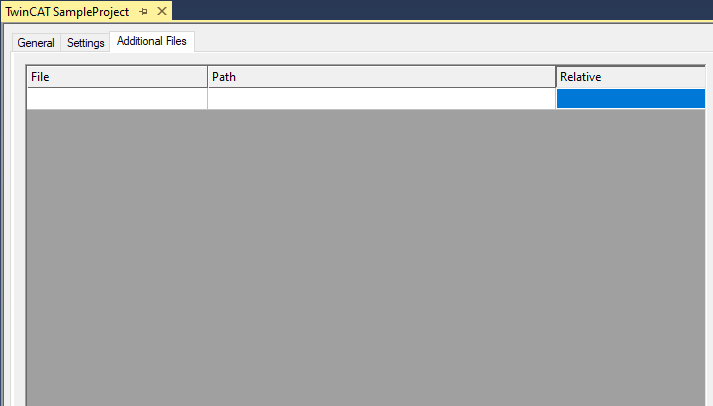

Additional Files tab
This tab allows adding further files to the archive files of the TwinCAT project.
Additional Files tab 1:
File
Double-click in the input area opens a dialog that allows you to select files you want to add to the archive.
Path
Display the path to the selected file.
Relative
Selection whether the file should be included with the absolute path or relative to the System Manager project.
