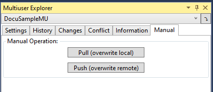

Manual tab
The Manual tab is used to write the current project status to the target system or to fetch it from there.
Manual tab 1:
Pull (override local)
Fetches the current project status from the target system and overwrites the local project. There is no merge of the project statuses.
Push (override remote)
Overwrites the status on the target system. There is no merge of the project statuses.
