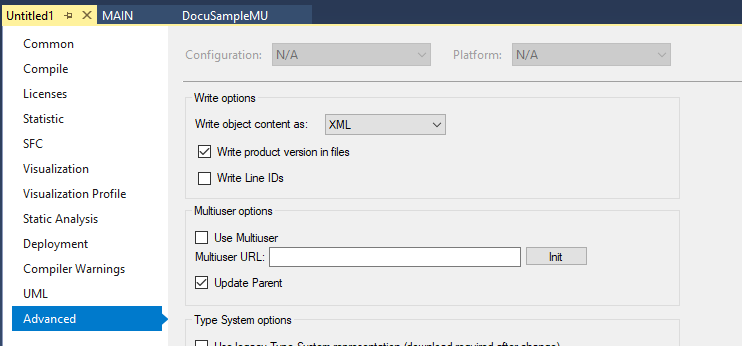

PLC project settings
To use the multiuser function only in one PLC project, this function must be enabled in the PLC settings.
PLC project settings 1:
Use Multiuser
Enables the multiuser functionality of the PLC project.
Multiuser URL
Displays the URL of the remote/target system repository.
Init
Initializes the multiuser function for this PLC project.
Update Parent
If the entire TwinCAT project is managed by the multiuser function, use this to activate that the TwinCAT project is informed about user activities that require an alignment of the repository (login, download).
PLC project settings 2:
Manage TwinCAT project as a whole
The current multiuser function can be used to manage either the entire TwinCAT project or the PLC project. Both are not yet possible, but will follow in a future version. If the entire TwinCAT project is managed, the multiuser function must not be switched on in the PLC, but only the Update Parent. In this state the TwinCAT project is informed about corresponding user actions, so that the update of the target system repository takes place from the TwinCAT project.
  • Activate the Update Parent.
