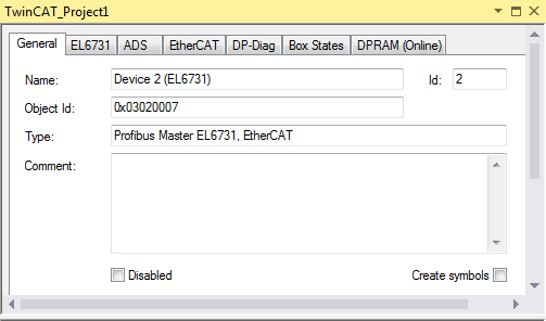

General
Name of the PROFIBUS device.
Id
The "Id" text box contains the identification number of the master device. Each master device has its own identification number. It is assigned consecutively for each new master device. If master devices are deleted from the configuration and numbers become free as a result, then the released numbers are reassigned to new master devices inserted into the configuration.
Object Id
The PROFIBUS device represents an object in TwinCAT. The "Object Id" text box contains the TwinCAT object identification number.
The method ITcComObject:TcGetObjectId returns the object ID of a TwinCAT object. Each instance of a TwinCAT module has an object ID that only occurs once within a TwinCAT runtime. The object ID can be used to identify an instance within the TwinCAT system.
Type
Type of the PROFIBUS device.
Comment
Here you can add a comment. For example on the plant part.
Disabled
Here you can disable the PROFIBUS device. A disabled device is not included in the configuration calculation. The configuration of the disabled PROFIBUS device is retained with its link information and can be re-enabled by unchecking the check box.
Create symbols
If this check box is checked, symbolic names are created for accessing this PROFIBUS device.
